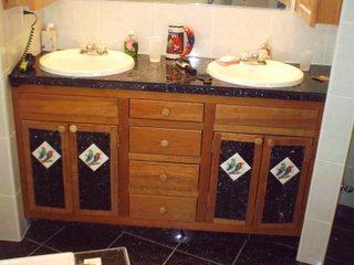

I've used it on a cherry vanity. I was given a quart by a local paint store to try out and yes it is very forgiving. It carries the KCMA (kitchen cabinets manufactures association) approval which means that it is tough and resistant to water and chemicals. Almost no consumer finishes meet the KCMA standards, catalized lacquers, polyester finishes are the norm. It cross links which explains its toughness. Overall I was happy with the results, low odor, very easy to apply, and so far seems to be holding up very well. Bathrooms are tough enviroments for woodwork. I've had callbacks on some of my early work finished in poly and standard lacquers that didn't hold up to the harsh cleaning and the humid enviroment of bathrooms. I wanted to try it again, but my local supplier decided not to carry it, minimum order requirements and local demand didn't match up. Would it make a good instrument finish? It would be tough but I dont know if it would give the depth and shine of lacquer.
edit: I have a pictures of the vanity, not the eyecandy that everyone here is used to, and I haven't figured out how to post pics here yet.Chris Ide39080.4391898148

Thanks Pat, dont know why I couldnt figure that out, but here it is not a guitar, but brushed finished in ceramithane,Natural cherry darkened with UV light, granite top, granite/tile panels in the doors. Watch out now lots of pics to show.
